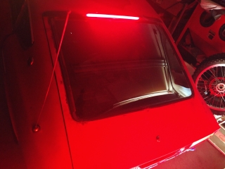

3rd brake light to help keep her safer
Ashley's Z -5752KB.jpg (67.16 KiB) Viewed 10150 times

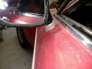

Miata pwr mirror adapted
Ashley's Z -761KB.JPG (60.66 KiB) Viewed 10150 times

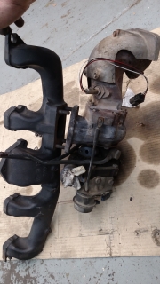

Z31 T3 turbo
Ashley's Z -3466KB.jpg (52.49 KiB) Viewed 10150 times

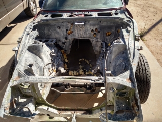

engine out and media blasted for engine bay paint
Ashley's Z -6478KB.jpg (84.43 KiB) Viewed 10150 times

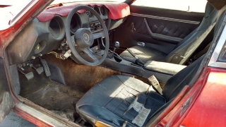

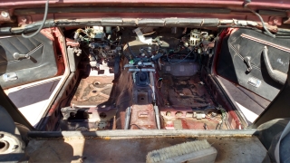

The wonderful interior, old and in need.
Ashley's Z -4404KB.jpg (60.56 KiB) Viewed 10150 times

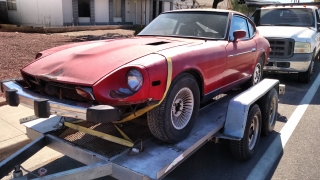

How she looked the day she came home
Ashley's Z -4336KB.jpg (61.11 KiB) Viewed 10150 times

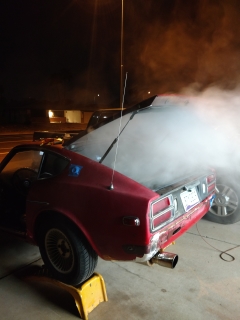

Just finished smoke testing for leaks. Found quite a number, some will be fixed now, others during the paint and body phase.

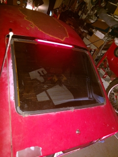

3rd brake light in the dark. Gotta be safe :-)

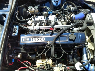

Ashley's Blue TURBO valve cover
Ashley's Z -6284KB.jpg (93.03 KiB) Viewed 10146 times

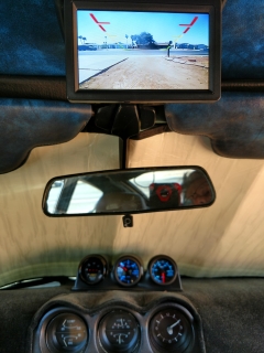

Camera monitor in the closed up position, tucks away nicely.
Ashley's Z -3182KB.jpg (46.59 KiB) Viewed 10146 times

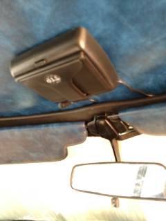

Monitor flipped down showing Rear backup camera, doubles as a front facing camera in forward gears. You can see it was intended by the mfg to be dash and not roof mounted. It still works pretty well.
Ashley's Z -4280KB.jpg (63.7 KiB) Viewed 10146 times

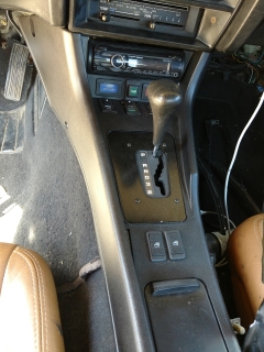

New console with the Gate shifter for the auto trans, also visable is the OD button to go along with all new plush carpet through out.
