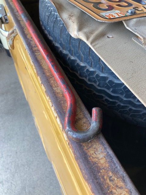

I'm trying to determine how to lower the spare tire under the bed. I have the long jack handle, that I believe is supposed to be inserted above the license plate holder and then turned, but it does not seem to engage anything. Any help/advice would be appreciated. Thanks!

Randy, the handle inserts into the carrier (see yellow arrow) and upon rotation, raises or lowers the spare on the chain.

Greg, I'm wondering if I might be missing the correct handle to insert. What I have is a 3-4 ft. red jacking handle that has a square tip on one end and a ring on the other. Does this look right to you?
