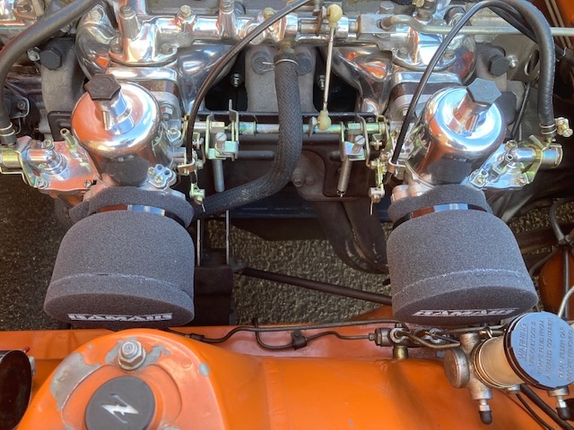

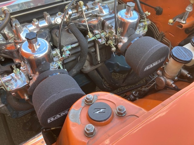

The foam in my ITG air filters were beginning to degrade significantly so I was looking for some different air filters. I was just running the aluminum air horns by themselves the last month, but was concerned about our dusty AZ environment, so wanted to find something fairly quickly. I ordered these RAMAIR filter socks from the UK and installed them today. I had to shorten them about 3". They're secured with black zip ties. I haven't oiled them yet and will probably just run them dry for a while.

I would not run them dry.  The oil is what traps the dust.

Yeah, your right Carl. I have the K&N spray, so I will do that the next time I have the car home.
