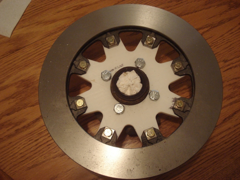

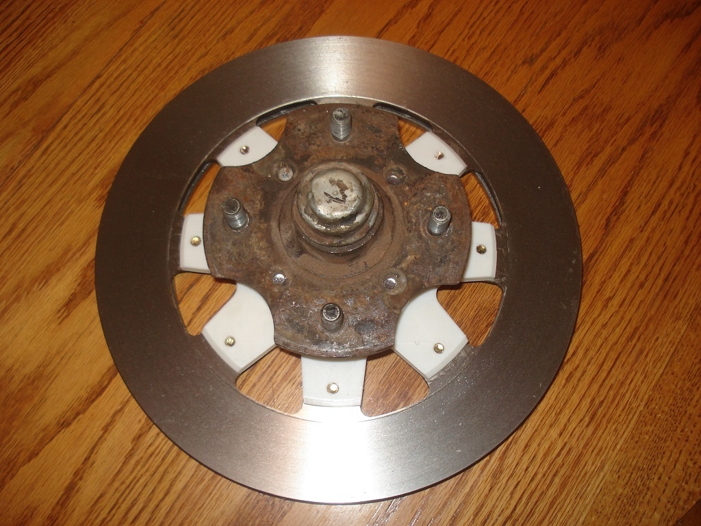

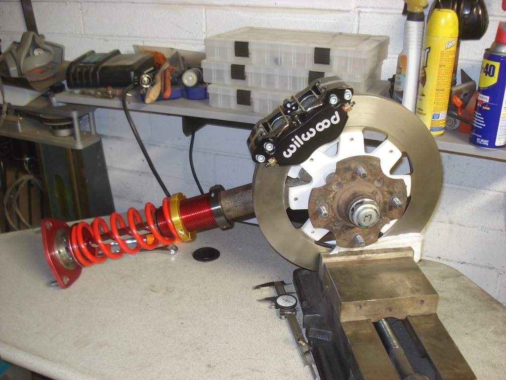

While I'm recovering from some minor surgery, I decided to work on my brake idea. I want to use the Wilwood 12" rotor and their Dynapro calipers on the front. I want to make my own stuff as much as possible, so I I did some measuring, head scratching, and drew out my ideas in Autocad. When I was happy with the fit, I imported the Autocad drawings into Fusion 360 and generated a 3D IGF file from my drawings.
With the IGF file in hand, I fed that into my slicer software and made up a G-code file to use on the 3D printer and made a mock up of my rotor hat to start piecing together the front brakes.
I will make the caliper mounting bracket next, then fit the wheels to check clearance.... Once that is done, I can take my drawings over to the shop to make aluminum parts with the knowledge that they are going to fit correctly. That's the plan anyways...
Plastic rotor hat mock-up
Hub back side with disc and hat attached

Hub front side with disc and hub attached

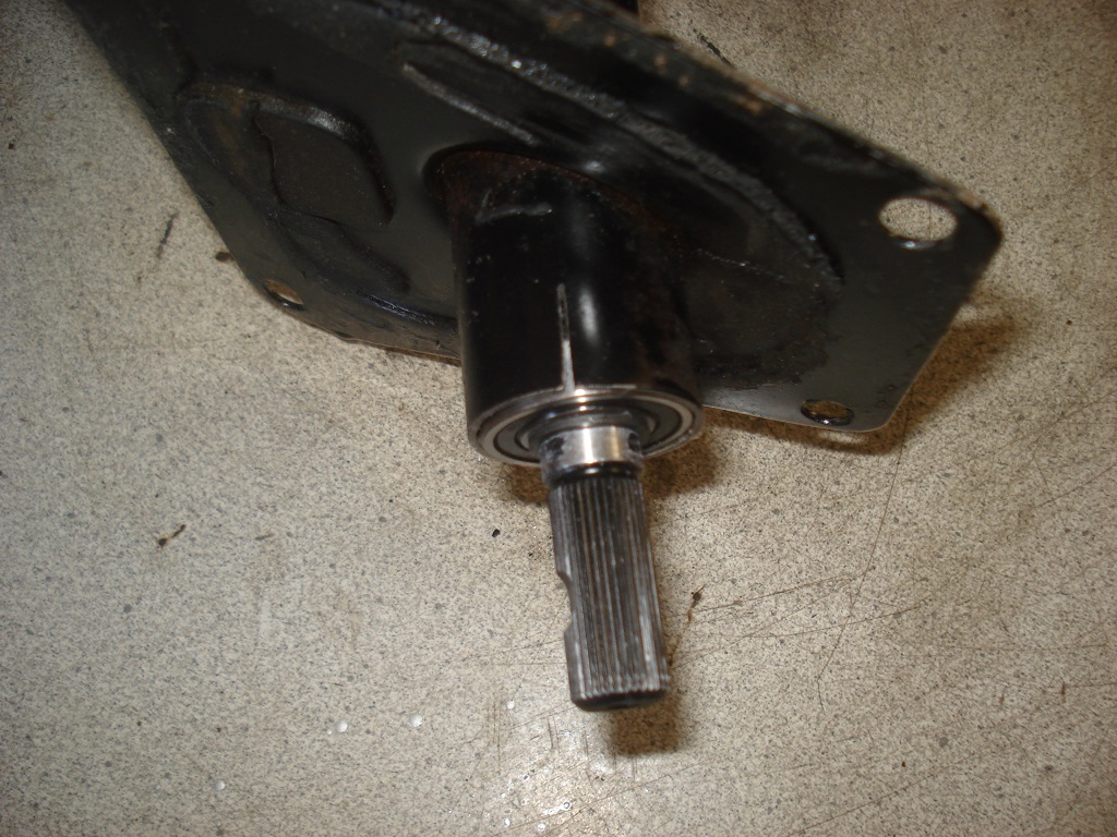

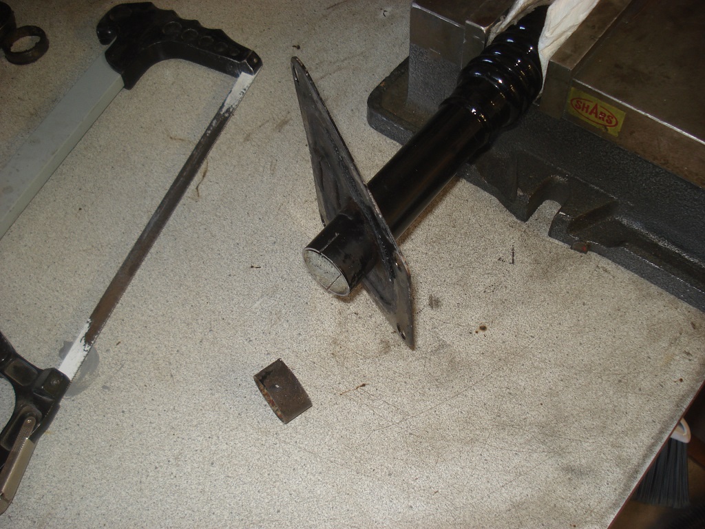

- I installed the new splined shaft and U-joints that came with the kit. This was pretty easy, had to shorten and slot the steering column tube, then it was just a bolt on install.
Shortened the column by 20mm then slotted end
Inserted the new splined steering shaft from the kit

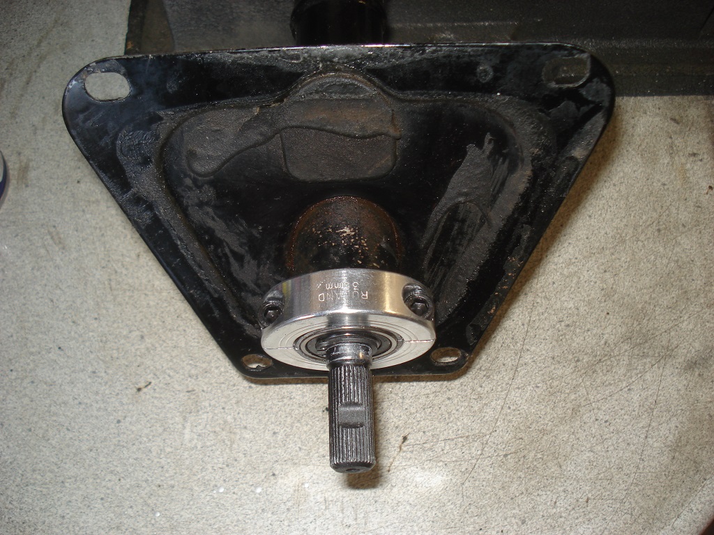

Collar retains the shaft bearing

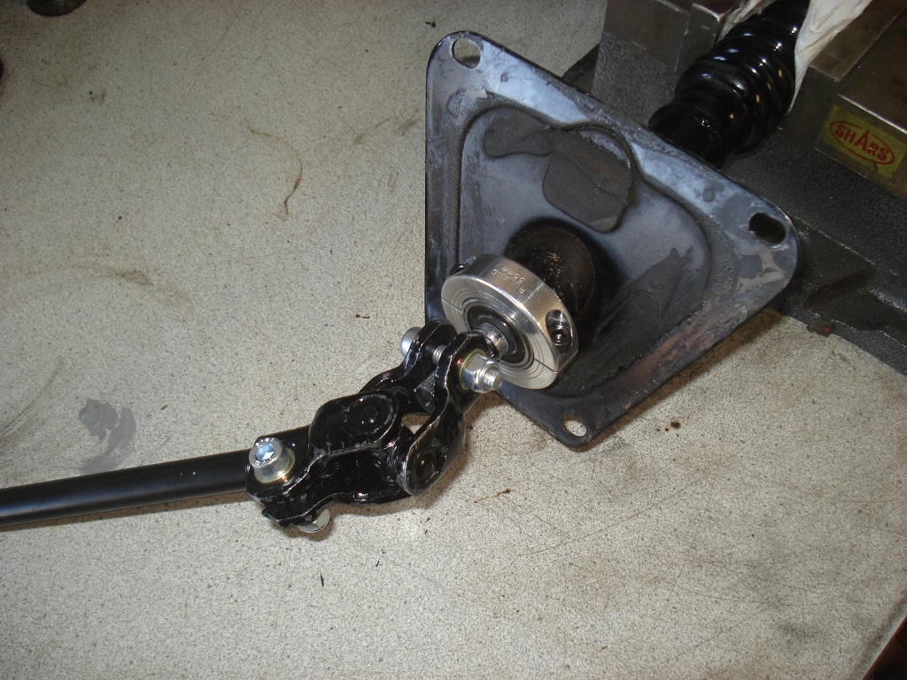

Attached the down shaft

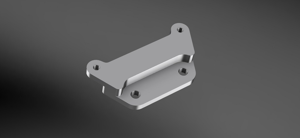

Still working on the front end. Getting close to finalizing my front brakes now. I designed the caliper bracket in Fusion 360, and printed it out in plastic. Had to do a couple of iterations to get the spacing right, but I'm pretty happy with the results. I rendered the caliper bracket front side in aluminum, and then did a back side render in walnut.... :roll:
Front side
Front side
Back side
Back side
Mounted my mocked up plastic brake hat and caliper bracket to the strut to verify dimensions. The rotor is a Wilwood 12.19" diameter, 0.81" thick ventilated, and caliper is the Dynapro (I wanted the black power coated finish, and the ability to change pads without removing the caliper).
Attached to strut
Attached to strut
Front side
Front side
Back side showing bracket
I need to mount to the car and check clearances next, but that's for another day.
