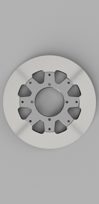

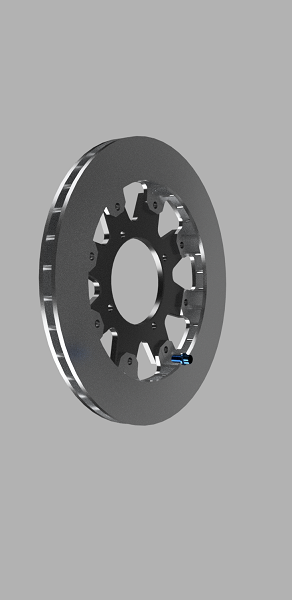

My wife is getting me a 3D printer for Christmas. When I saw your post about Fusion 360, I decided to take a look at it. That is some amazing software. I used Autocad to design quartz ware for the reactors at work years ago and thought that it was pretty hot. The Fusion 360 pretty much makes it look primitive. Of course, it is significantly more complicated than Autocad, but there is so much info on you tube and the Autodesk sites that it is possible for an old guy to start getting the feel for it.
I down loaded the demo software about a week after your post, and have been playing around with it since then. I just finished a drawing of a Wilwood 12.19 inch disk rotor and a rotor hat that turned out pretty nice. I will be taking some more measurements to finalize my rotor hat, then see if we can build it at the shop.
My next project for Fusion 360 is to design a center console for my 510 that can be 3D printed. I'm still a long way from getting a handle on some of the features yet to make that happen, but am having a lot of fun learning.

That rotor looks great!
You can get a free license for Fusion if you are a startup, or a "maker." That way you don't have to worry about the demo expiring.
I used to compete in AutoCAD in high school in the mid 90s, and it amazes me how far the software has come, and what it is capable of.
Fusion is also nice because of the huge amount of online tutorials and videos.
