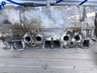

Hi guys,
I have a cylinder head that came with other stuff I bought.
The only identifying makes I see are
On the spark plug side: Nissan Japan 210 M
On the back of the head: 3-24 #28
Any help would be appreciated
Thanks,
Rob

4 or 6 cylinder? A picture would be helpful.

4 cylinder. I’ll try to get some pics posted tomorrow.

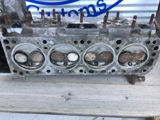

Here's some pics of the head.
Hopefully someone can help me identify it.

This is a job for Doc. Doc, are you reading this?

Posted: Wed Feb 23, 2022 10:20 am
by Randalla
