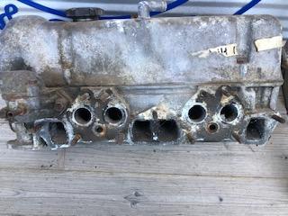

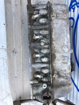

Hi guys,
I have a cylinder head that came with other stuff I bought.

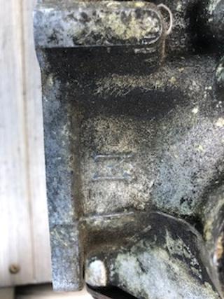

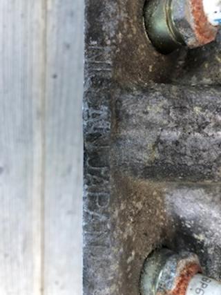

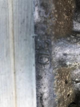

The only identifying makes I see are
On the spark plug side: Nissan Japan 210 M
On the back of the head: 3-24 #28
Any help would be appreciated
Thanks,
Rob

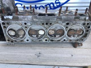

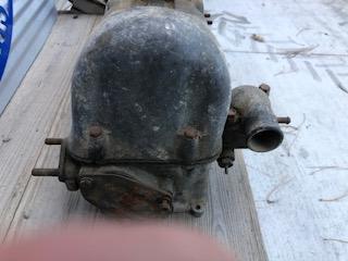

Here's some pics of the head.
Hopefully someone can help me identify it.

Posts: 946
Re: Help identifying head
Hi Rob, FYI, just spoke to Doc who viewed all your photos and asked me to pass on his thoughts. He said it's obviously an early L-series head, based on the casting number (210), which he recognized. It was used on a 510 (the 210 is just a casting number, not the Datsun model that used it). It's not a desirable/performance head (small valves). He wouldn't use it on anything. Jokingly, he said the only part worth saving is the thermostat housing.
