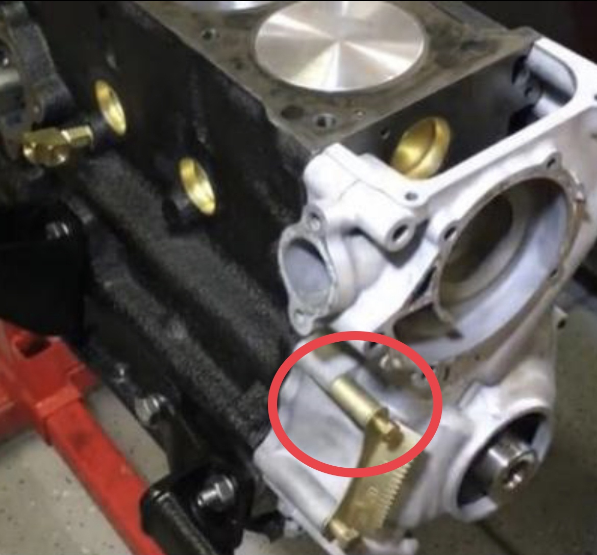

I am looking for the part circled to use the 280zx timing plate anyone have one? Stand-off, spacer, bushing not sure what you want to call it

I measured mine on the stand.
Just go to your local ace hardware, buy a bushing, roll pin or whatever with the proper ID for the bolt. Cut to 28mm in length, party on!

Awesome that’s great info
