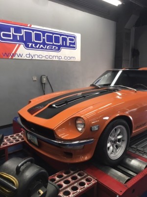

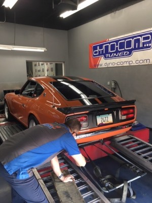

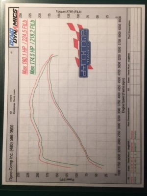

Took the Z into Dyno-Comp in north Scottsdale this morning and learned a lot in the process. The owner of the shop (Richard Garcia) ran 2 baseline pulls for me without any tuning. The first pull was 180 hp and 225 ft lb of torque. Car was running on 87 octane with 34 degrees of total timing. He suggested a number of easy things to do to gain another 8-10 hp. This was horsepower at the wheels. Horsepower at the crank would equate to roughly 207 as compared to the original factory number of 151. Needless to say I was pleasantly surprised. You'll notice in the printouts below I have some work to do on the air/fuel ratio from 2,000-3,000 rpm.
The cost was $140. Was thinking maybe I can negotiate a group buy if there are enough others interested in doing the same thing (Stephen, Chuck, Patrick, Craig, Russ, etc.?).

I forget what cylinder head is on that L28 Randy?
Posts: 937
Re: Dyno Work
E-88 head, F54 turbo block with dished pistons, 480 lift and 276 duration cam, stock cast iron exhaust manifold, 2 1/2 inch exhaust with straight through glass pack muffler, stock SU carbs with SB carb needle profile and Pertronix electronic ignition with 34 degrees of total timing.
