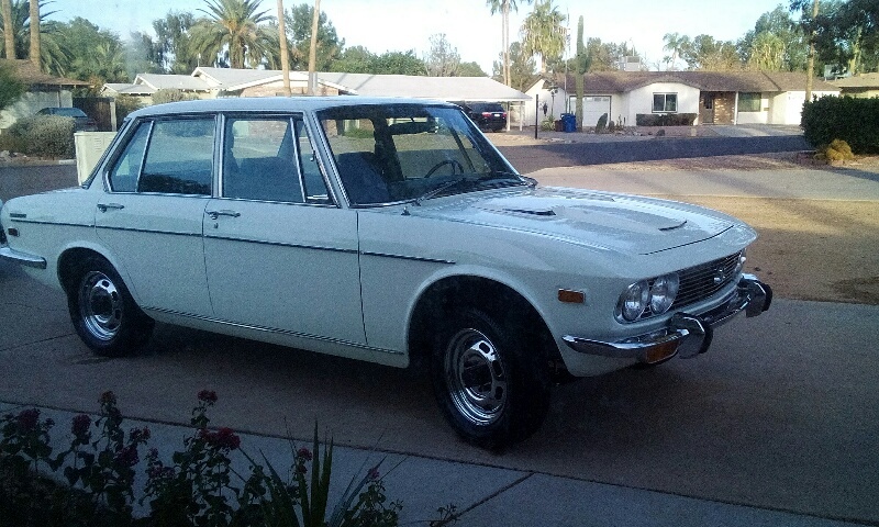

Datsun may have had the Fairlady, but Mazda had "The Leading Lady". The Mazda 1800, known as the Luce in Japan, was powered by a 1796cc OHC four cylinder engine with a single side draft Hitachi SU carb. Rated at 104 HP from the factory the performance was only average but did include some nice upgrades as standard including a fully finished trunk.
I rebuilt the engine in this one two years ago but suffers from worn throttle shaft bushings and runs on the lean side. I try to compensate by running a heavier weight oil in the dashpot and cheating the choke out 1\8". Contacted ZTherapy about rebuilding the carb a few years back but they passed as they were unfamiliar with this model. Some have resorted to a Weber conversion but for now I will leave as is.

Interesting bit of Mazda history I had not heard before. Your car looks a lot like the love child of a Datsun 411 and a 510. Curious to know what the carb looks like. Do you have any pictures? Are parts available? You'll have to bring it out to our next event. Thanks for posting.

Very cool Mazda. I'm not familiar with that model. I like it
