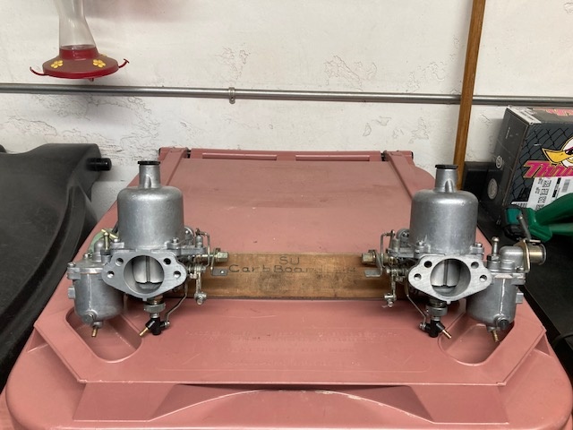

Good morning today working on Clarence thanks to Ron Q. We were finally able to bleed the brakes after installing new rear brake cylinders. Though I had previously bench bled the brake master, when the rear brake cylinder let go air must have gotten back in the master. Once we bled the master again we were able to re-bleed all four wheels and verify we had a firm pedal and the brakes were working. We were also able to get the car idling nicely today and shifted through all four gears and reverse with the rear end raised up on a jack. I also finished re-building a set of SUs for a customer. Still waiting on new float bowl hoses and clamps.

It is interesting, Randy, that new Ztherapy fuel hoses are not the pre shaped ones anymore, they are straight hoses. I wonder when that changed?
Posts: 937
Re: Clarence followed me home
Noticed that in my last couple of orders. So far the straight ones do not seem to kink so I guess they're alright. I have a call in to Bruce to order a bunch of carb parts. I've now got 4-5 sets I'll be rebuilding over the next month.
