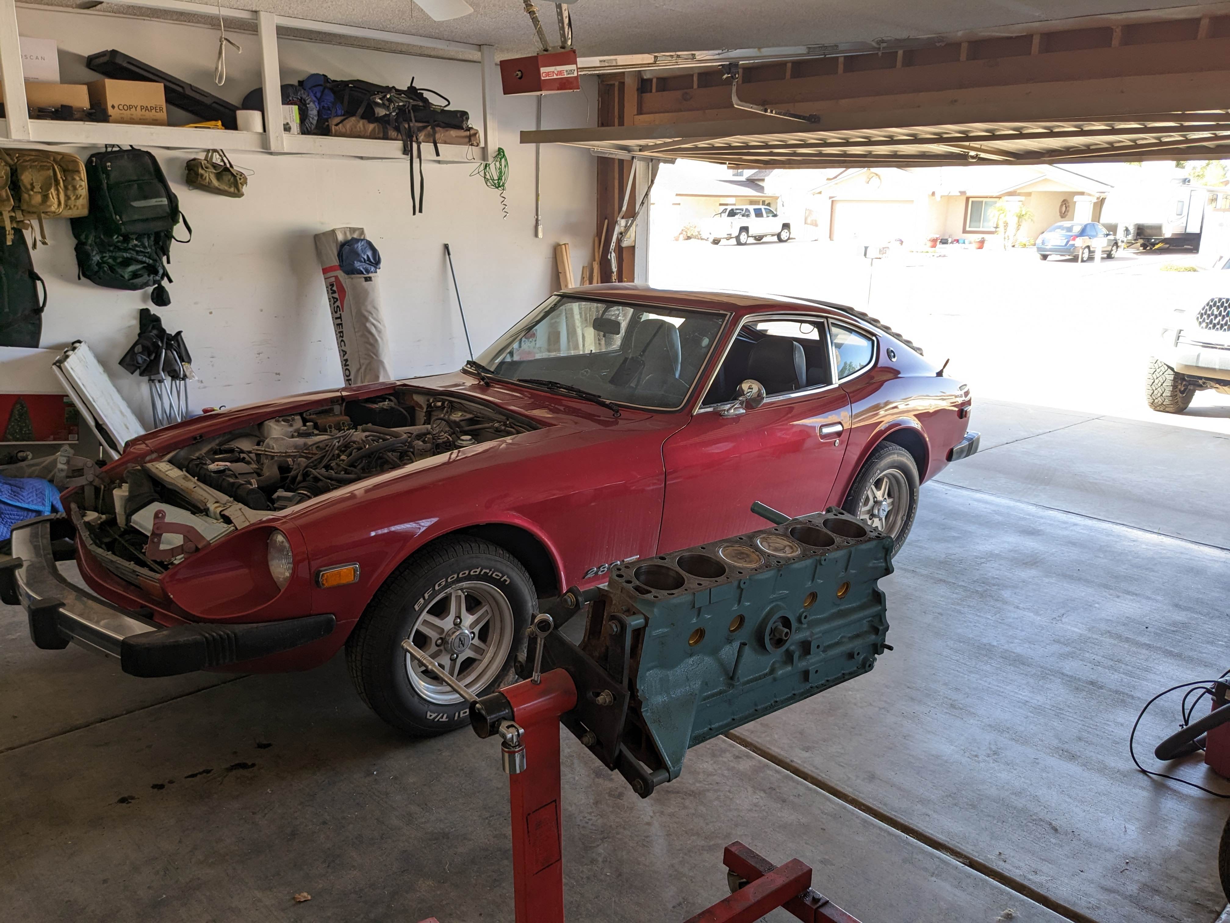

Got my pistons and rods installed, but realized I used synthetic oil to lightly coat the rings and skirts. Will I be ok, or do I need to take em back out, degrease and redo with conventional or wd40.
I didn't do the recommended dunk in oil method from the "rebuilding a Datsun" book. Read the rings will seal better with a light coat.
Your help is appreciated!
