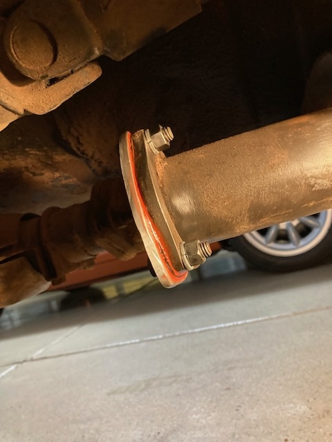

Good day today with some significant progress. I finished patching up the harness from the engine through the firewall into the passenger compartment and finally removed the last of the added on junk from the previous owner. With some starting fluid I was able to get the car to fire and run briefly. That brief run was really loud!!! I remembered when previously under the car noticing someone had plumbed in an electric exhaust system bypass. Being open, this had the effect of running an open header in terms of noise. I ended up removing the bypass and fabricating a block off plate, so the exhaust now runs through the stock pipes and muffler. I didn't have a chance to fire the motor again after completing and bolting up the block-off plate, but will tomorrow.

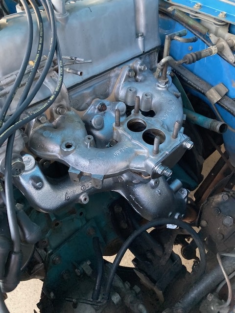

Finally getting back to working on Clarence again. Decided to remove all the emission equipment since I'm replacing the stock carb with a Weber 32/36. This required quite a bit of work, including some fabrication to plug holes left from the removed parts and having a baffle cut out of the cast iron exhaust manifold. Also lots of cleaning and painting to help tidy things up in preparation for the new carb. Here's where I'm at as of today.

What did you coat the exh manifold with? I have a 4/2/1 manifold that you can have if you decide to ditch that horrible 4/1.
Re: Clarence followed me home
It was sprayed with high temperature bar-b-que paint. Supposedly it will withstand temps up to 1200 degrees, but I'm sure it will flake off at some point. I'd like to hear more about the exhaust manifold you have. Is it a stock piece for an L20B? Could I use it with the intake manifold on my car? Thanks for posting.
