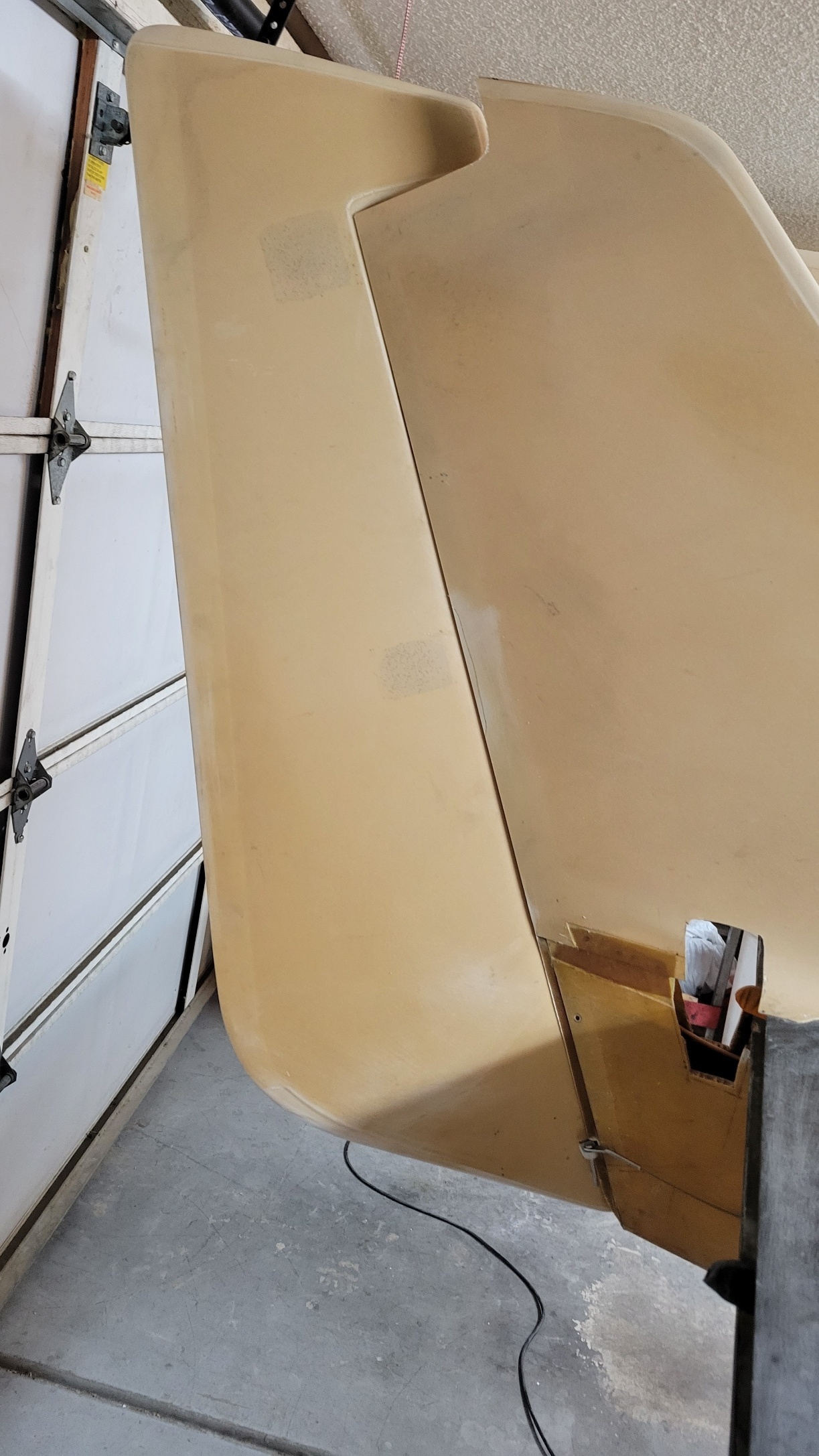

I got the rudder attached and working.

Chuck, that rudder must look sharp on your Z, am sure it will help you move down the road!!
