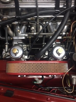

Was having intermittent fuel delivery/running issues this past week and noticed one carburetor nearly dry when I popped the lids off. Decided to replace both float valves with a pair of new ones I had, which immediately solved the problem. Interestingly the float valves I took out were completely different from each other, which may have also contributed to the problem. All good now.

That's great Randy. Always nice when a problem is fixed!
Carbs look great, glad it's running nice.
