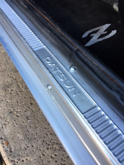

The aluminum sill plates on the car were pretty ratty looking. I started by hammering out all the dents and imperfections and then wondered how they would look after soda blasting them. They were definitely better, but the finish was kind of uneven. I decided to see how they would look painted silver and I think they turned out pretty nice. I spayed them with two coats of Rustoleum Silver Metallic and then two more coats of clear. Here's a couple photos of the final installed product. I wish I'd shot some before pictures, as the change was pretty dramatic. You can also see the Kia Sportage door seals I installed.
