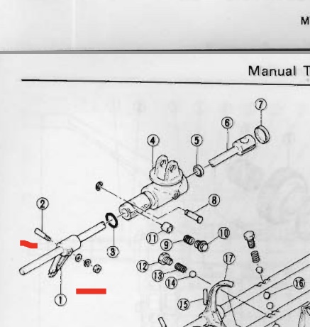

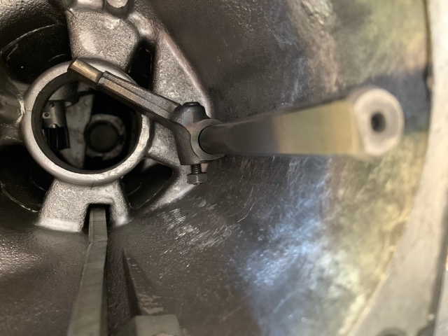

I need to get the wedge pin out of the striker arm it’s #2 underlined in red. There is no easy way to get in there to punch it out but maybe someone has better tools to accomplish this. This is on the 77-78 5speed tail housing. Willing to drive/pay for time whatever needed I just need that out so I can replace the o ring. It’s the same shape as the spindle pin lock

Yeah I tried c clamps and motorcycle chain breaker nothing fits in that small of an area.. I did try a crow bar but couldn’t get it out either. Do you have any contact for that shop?

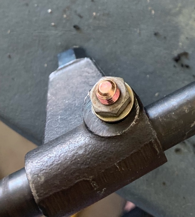

I used a air hammer on the lever down towards the inside of the case with a nut on the wedge bolt and the thing pops right out

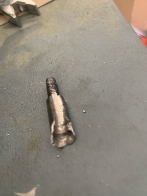

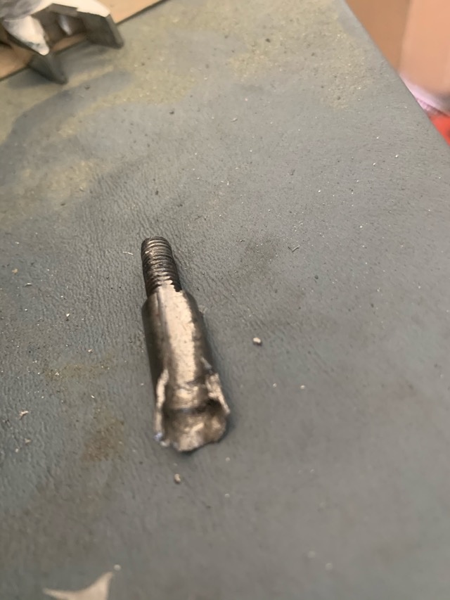

I drilled it out took me about 4-5 hours gradually stepping up bit sizes and hammering on the bolt.
