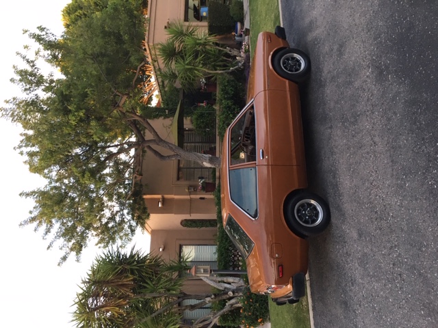

This thread is looking at the issue of photos from cell phones that can be rotated 90 degrees when posted to the forums. Trying to evaluate some work around approaches or possibly installing a beta release extension to see if that helps.
This is a test from a rotated photo. I downloaded it, then saved it under "Paint", then posted. No changes were made to the photo, it appears that paint has changed the EXIF file to make it appear in the correct orientation.

Test 2. I downloaded and saved the first photo to IMG 4260-new. No rotation. The second photo I downloaded and the posted without saving in Paint. Rotation still present.

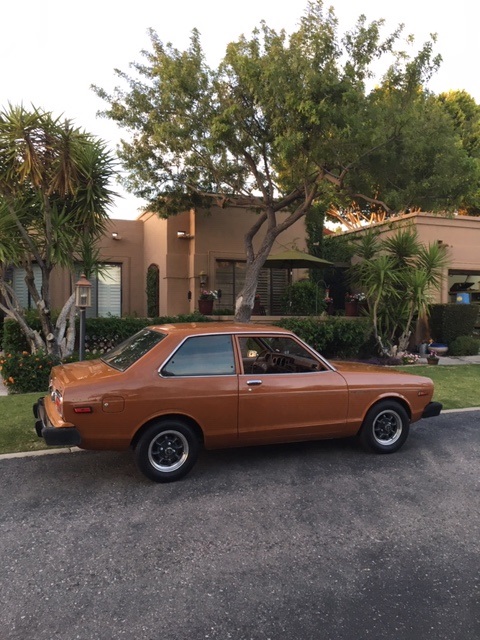

Look what happens when I save the original picture, rotate it 90 degrees in Paint, and then use the "Place Inline" button...
(you have to click on the picture to see what happens)

I have now turned on the "create thumbnail" option for posting files. It presents the photos in a smaller thumbnail format which expands to original size when clicked. It is interesting, because the thumbnail view actually reads the EXIF file, but the fix has not been extended to the full size photo at this time. Saving in paint again seems to reorient the photo to the desired appearance.
Original photo
Same photo after I saved it in Paint. No changes, just saved it.
