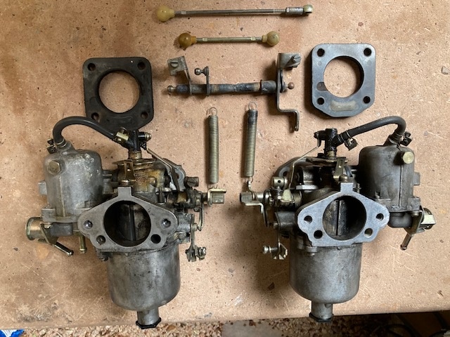

Yesterday I stopped down to George Geringer's and took the SU's off his 73 240Z, which he claimed had not been fully gone through in over 220,000 miles. If that's true, it can only be because George drives his car a lot so fuel has not varnished parts to the point of sticking. George said soon after he bought his Z the stock flat top carbs were swapped due to the well known vapor lock issue. I was feeling inspired by Paul's excellent documentation of the work he did on Greg's 411 wiring so I thought I'd attempt to do the same on this rebuild.

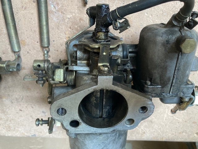

While removing the carbs and linkage yesterday I noticed a few obvious things needing attention. The phenolic spacers between the carbs and the intake manifold were incorrect. They were the thin version that came with the flat tops and were not nearly 1/8" thinner than the ones used on the round tops (probably would make little if any difference in the way the car runs). Two of the throttle rods with the plastic ball ends need to be replaced as they were badly cracked and just barely hanging on. I also noticed that neither of the float bowls had gaskets on them, which is a potential fire hazzard. Additionally, the center link connecting the two carburetors had been modified/bent/welded, so there was no way to adjust the piston lift in each carb to synchronize them under acceleration.
In my next post I'll detail what I find after opening the carbs up. These carbs did come off a running/driving car, so I'm not expecting to find too much wrong with them that a full clean-up and tune won't improve dramatically.

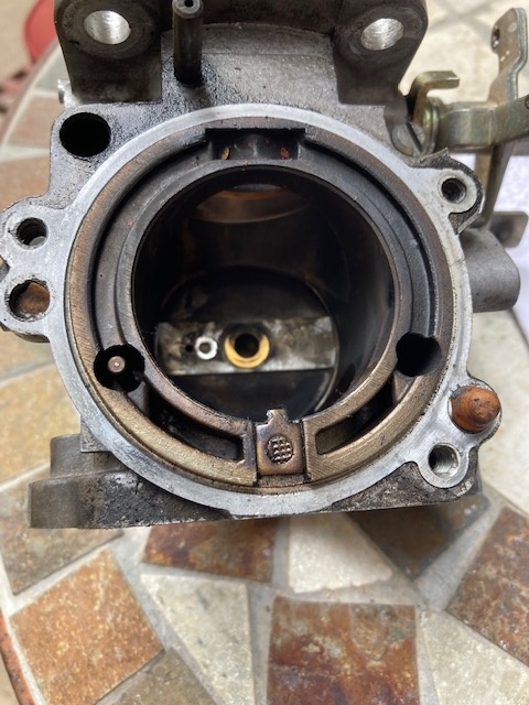

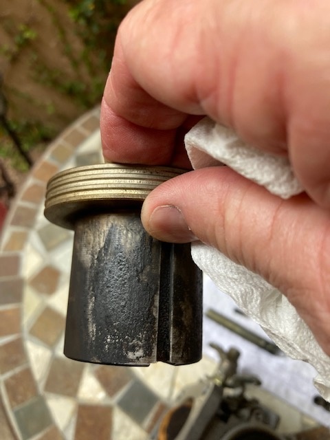

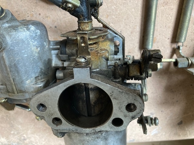

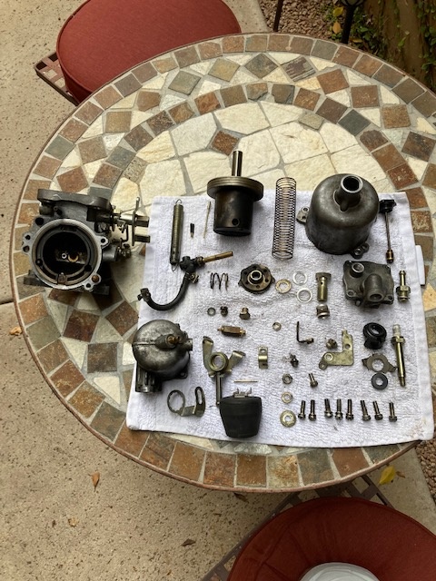

Well, I've got the first carb disassembled, and other than years of grime everything looks relatively intact. The first photo shows how far I typically tear carbs down when doing my rebuild (I count 66 parts). You can see in the other two photos just how gummed up the throat of the carb and the piston got after ??? years. From here everything will go into my carburetor Jacuzzi (hydro-sonic cleaner). It actually does a pretty good job of knocking most of the scud off. Hats off to Doc who gifted me the Jacuzzi (thanks Doc). It has a heater and a timer on it, making it both effective and easy to use.

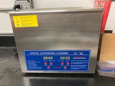

Re: 240Z SU Carburetor Rebuild
Here's the "carb Jacuzzi" I mentioned.

Very cool on the needles and other SU parts! What's an ultrasonic cleaner that size run?

Looks like Walmart has the same ultrasonic cleaner I have for $70. I'm using a Simple Green product in it diluted 4:1, but not the green stuff because we learned it will etch aluminum. The stuff to use actually says on the jug that it will not etch aluminum and it is purple colored. You can pick it up at Home Depot. Re: your race car, it would be a shame to leave it in MI or sell it. Hope you're able to find another alternative, Jeff

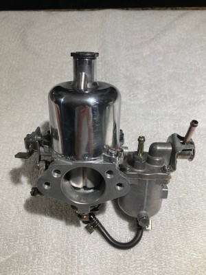

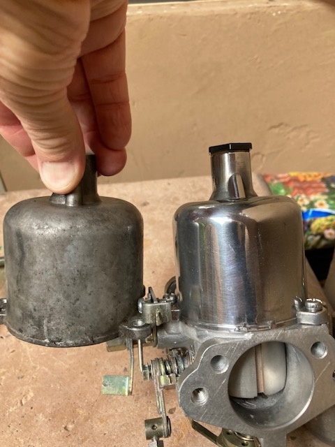

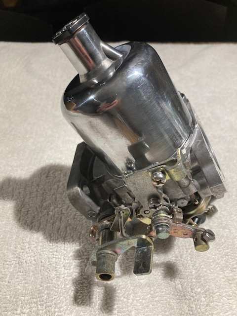

Thought I'd have some fun with the domes on George's carbs and surprise him so I'm polishing them. Below is the before and after.
Finished the first carb up today.
