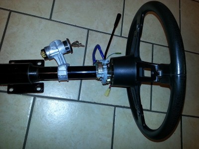

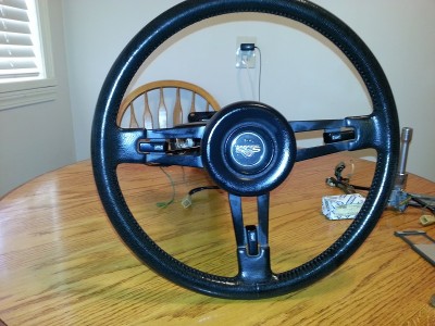

				Scored a nice SSS steering wheel from Tokyo-2U.  Its from a 74 610SSS and I think will go well with my plans for a retro build.  I also re-keyed my ignition switch to match my other locks.
-  Rekeyed ignition switch
-  SSS Steering wheel from 1974 180B

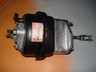

				Scored a booster from a guy on The 510 Realm......  May have to get the booster rebuilt, but was happy to get my hands on one.  Tough to find, originally from a B-210 .
-  B210 vacuum brake booster
