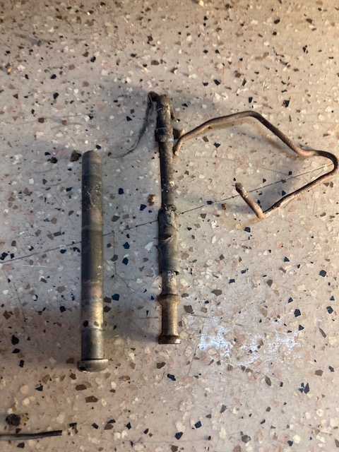

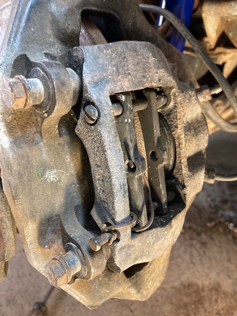

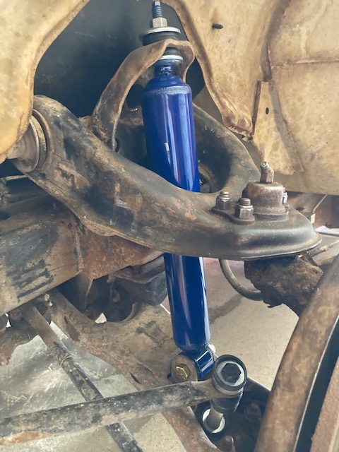

Today I finished bolting on the front shocks and new stabilizer bar end links. In the process, I evaluated the front disc brakes. I'm constantly amazed at the crazy stuff people do, jerry rigging things (potentially dangerously), rather than just replacing with the correct parts. Today I found one of the slider pins on the driver's side brake caliper substituted with what looks to be some type of construction fastener and piece of wire wrapped around it to hold it in place, Arghhhhh! Also noticed the inside pad on both driver and passenger sides was nearly gone, while the outside pad still had over 50% life left. Picked up new pads and hardware kit at O'Reilly this afternoon. Both rotors look like they'll need replacing as well. Since this 1977 truck did not come from the factory with front disc brakes, I was unsure if they were Datsun 620 or something else. After matching the pads up, it appears at some point the brakes were upgraded with 1978 or 79 620 parts.

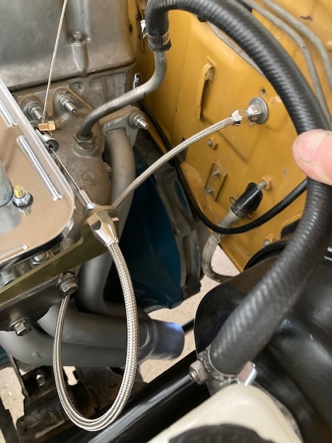

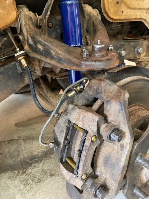

Got new front brake pads and hardware installed today as well as my Lokar accelerator cable. Despite looking pretty nasty, I was able to get all the front brake lines loose without rounding the corners of the fittings. Still need to order and replace both front rotors. I know I did this backwards, but all the cleaning is now behind me and it will be really quick to swap out the rotors when they arrive. Been keeping track of all my expenses and at this point I'm still under $5,000, all in. Definitely a budget build.

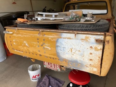

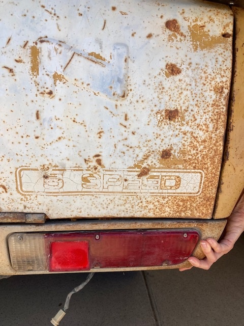

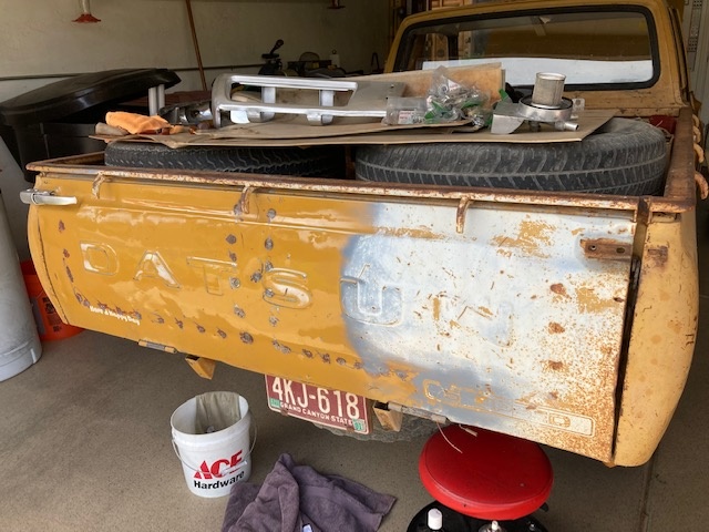

Last Saturday I got bit bad by my grinder, and today ended up at a hand surgeon to assess the damage. Fortunately I was lucky, no surgery and everything is intact, though still pretty painful. Slowed me down for a few days, but hard back at it today after hearing my doctor's assessment. I'm waiting on a pair of front brake discs, which I expect to arrive tomorrow, so I've been working on a few cosmetic issues. The tailgate is pretty rough and had multiple layers of paint on it over the butterscotch. I've been slowly working on removing the white and gray paint to get to the original paint, while still preserving the " 5-Speed" and "Have a Nice Day" vinyl appliques. Keep in mind this is a budget build. My intent is to make this a "work truck tribute", so the flaws just add to the truck's and the original owner's history. I'm really starting to embrace and have fun with this concept, and even tried reaching the original owners son this evening to get some history, hear his recollections, and share what I'm doing.

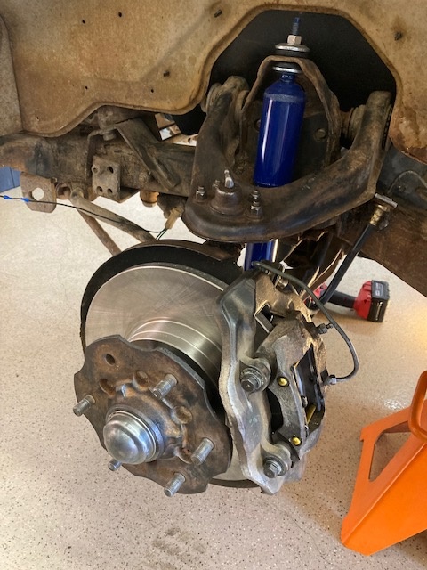

Finished replacing the front rotors this morning and one wheel stud that had been broken at some time in the past. Thanks to Carl and Peter for the tool loan, as I never would have been able to get the floating brake calipers off otherwise. That completes the front brake system. Now on to the rear brakes and rebuilding the emergency brake. The clock is ticking and I'm beginning to wonder if I'll have it done to drive to the Williams show October1st.

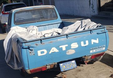

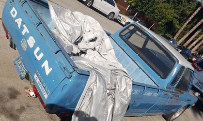

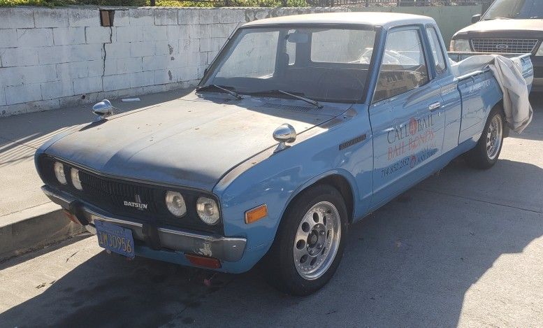

Just found this 620 for sale. Looks like its owner may have had a similar vision for his truck (check out the company name on the doors).
