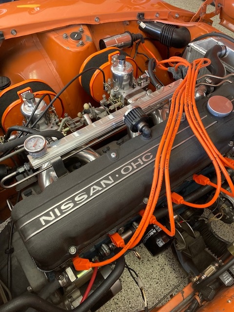

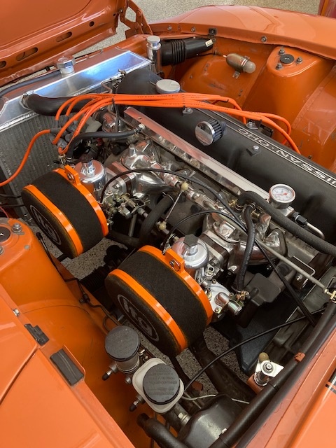

. I was under the Z's hood the other day and decided the red ITG air filters really needed to be color keyed to the rest of the car (orange). I'm sure I'm the only one that would care, but it's one less thing to drive me crazy.
Looks good Randy.

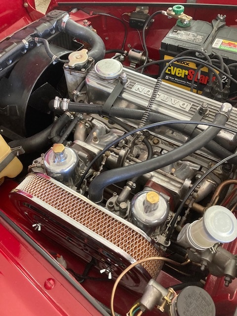

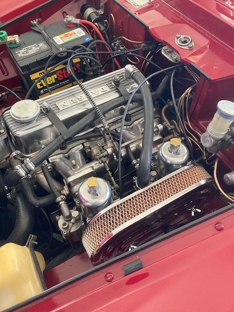

Traded Guy Pepoy for the newly installed "chrome" air cleaner on the Roadster (Thanks Guy). Duffman, I can't believe you've sucked me into the bling vortex!
Ha! Actually I noticed the color mismatch a while back. I never gave it a second thought to changing the color. Leave it to you to go the extra mile. Nicely done Randy!

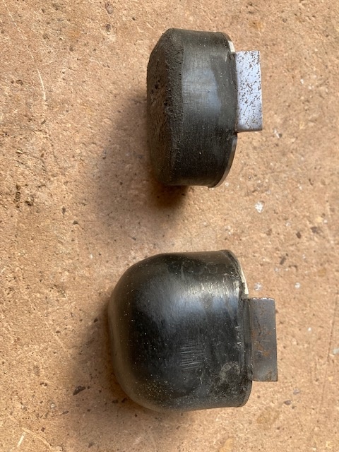

Experienced some teeth rattling banging in the front suspension after installing new front lowering springs on the Roadster. Thought I had the shorter bump stops on my car, but greasing the top of the bump stop tops confirmed they were bottoming on the A-arms. Pulled them off this afternoon and cut them down to size. Ended up taking about 1" off, as shown below. Solved the problem.
So nice when there's an "easy" solution!
