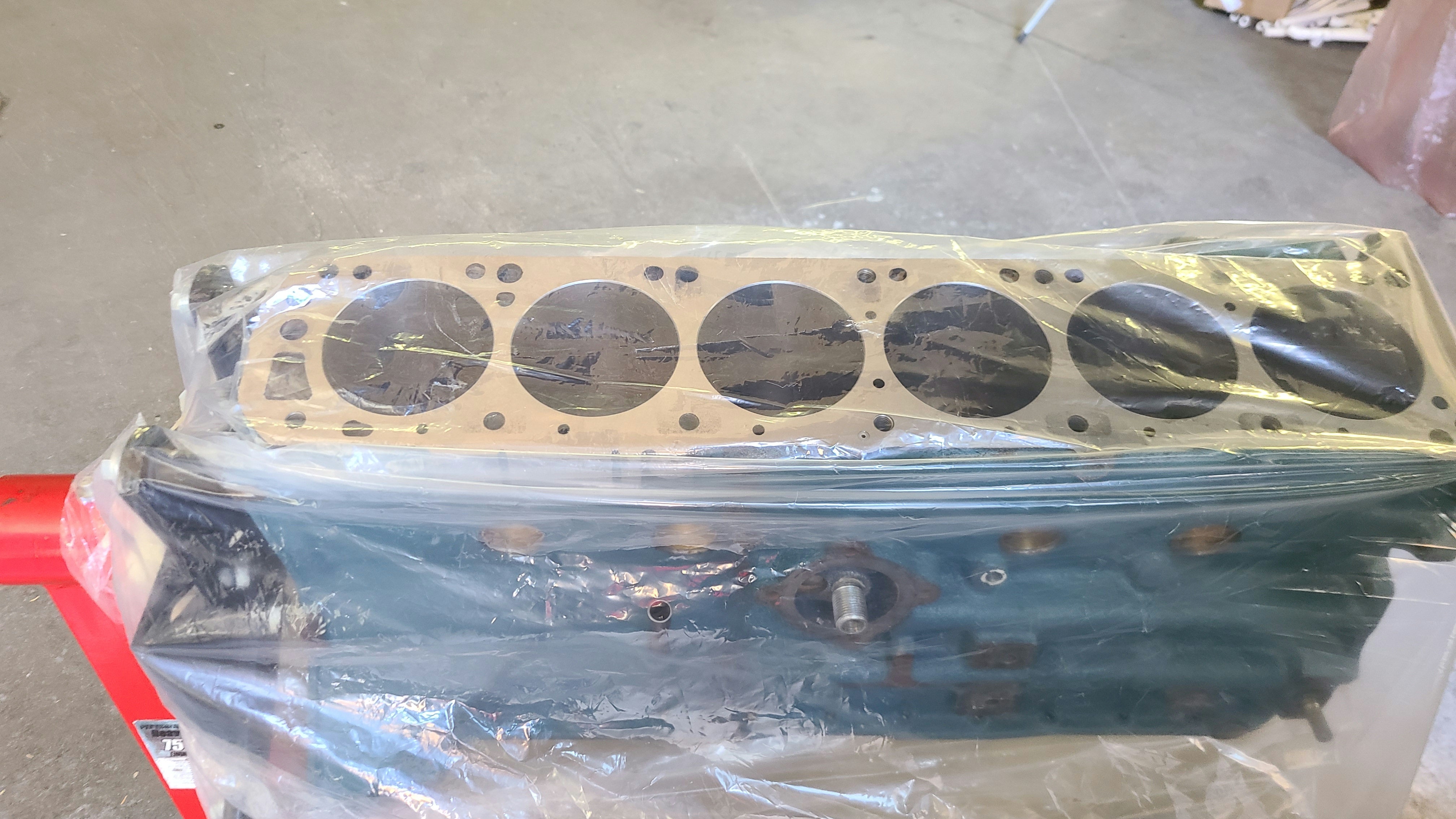

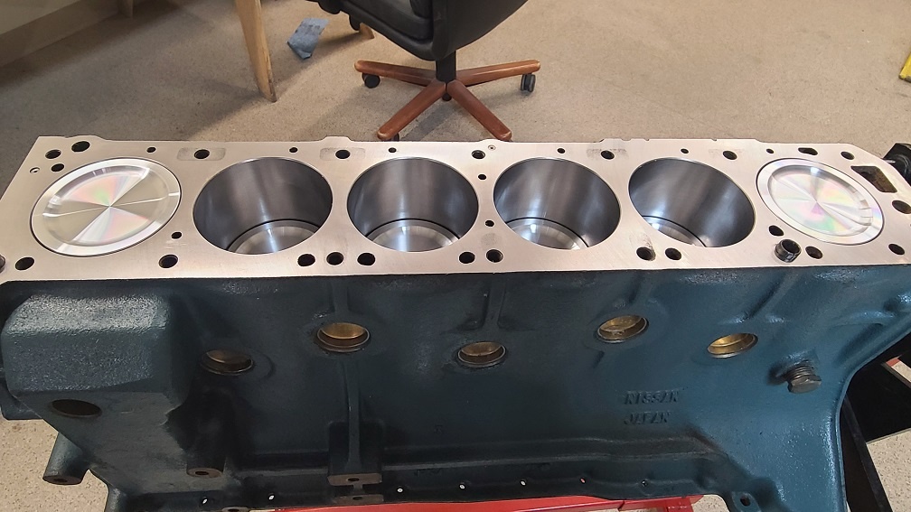

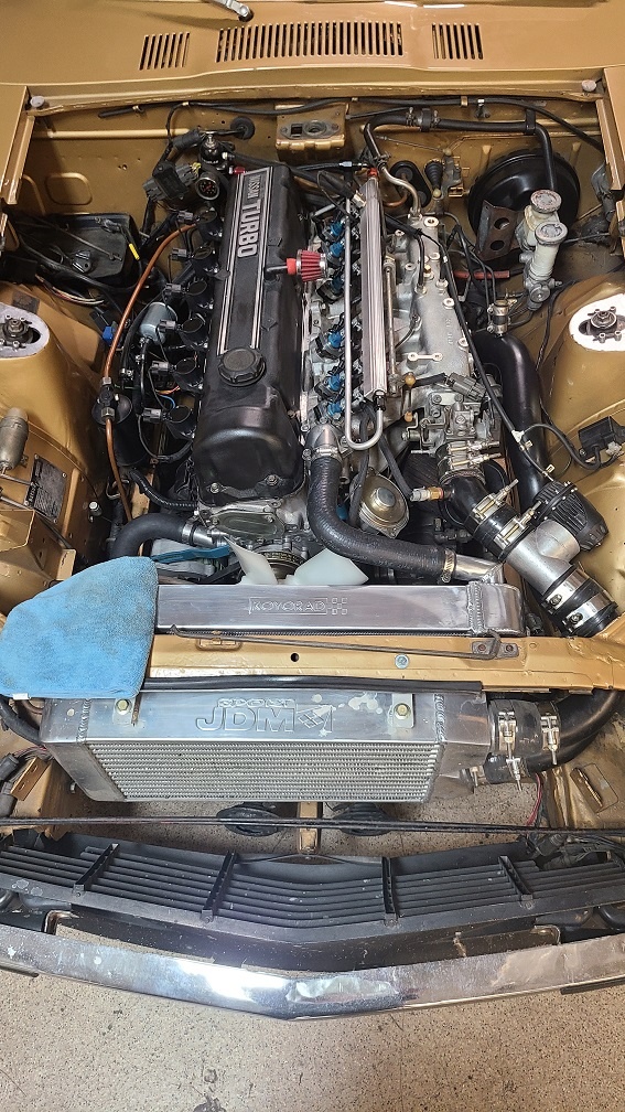

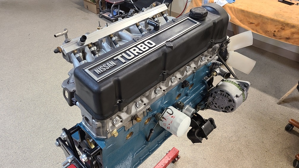

Okay, for those of you who don't know, here's what I've been doing on Goldie for the last few weeks.
A few months ago I broke 5 of the 6 new ITM pistons I installed not that long ago... Deep sigh...
SO. After anguishing decisions, I had Doc get me custom forged pistons made with custom rings, bought I-beam rods, and had my block bored another .5mm over. It's now at 87mm bore. Automotive Machine of Scottsdale did the bore and surfacing of my block and balanced the rotating mass of crank, pulley, flywheel, and clutch package. The engine is now reassembled and back in the car and running very well. Pictures:
