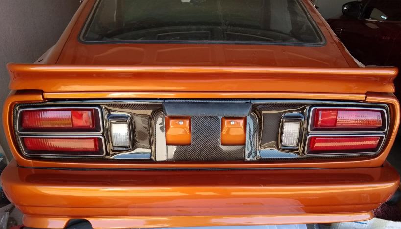

After going through a couple sets of tail light surrounds (sun soaked 40-year-old plastic just crumbles if you look at it wrong) I purchased these carbon fiber surrounds a few years ago.
I decided the chrome trim rings would not go well, so I sanded my worst set and painted them with "black stainless steel" paint. I am pretty happy with the way they look, but what a pain in the ass!
I know CF is made from ground unicorn hooves or something magical, but for $300+ I should not have to do a bunch of hand fitting to get them to work. I ended up burning 4 days on this project. Probably would have taken an hour to put the stock ones back in.

Looks nice.
Nice job Carl. It looks good, plus the carbon fiber taillight panel easily adds approx 20HP! ;)

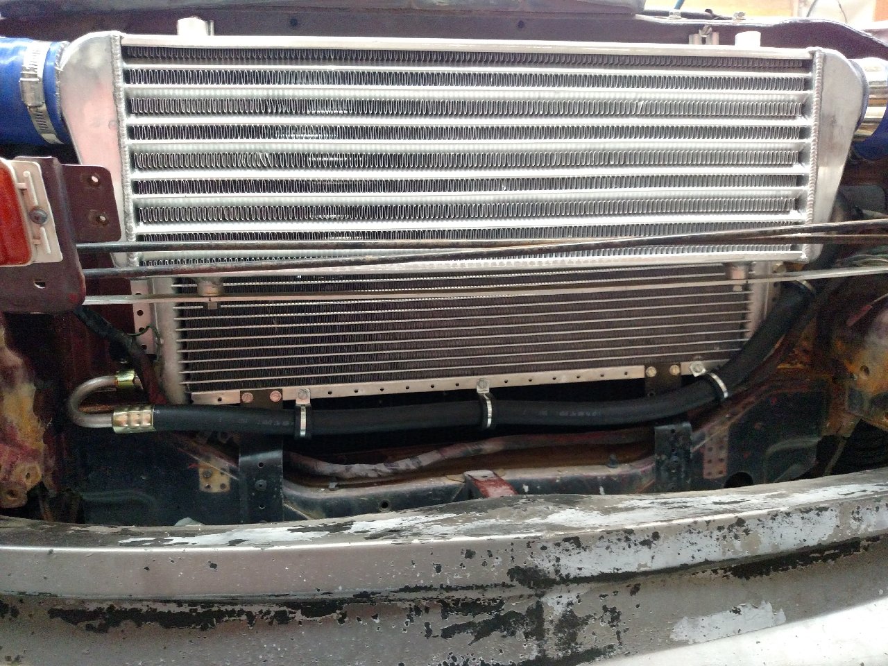

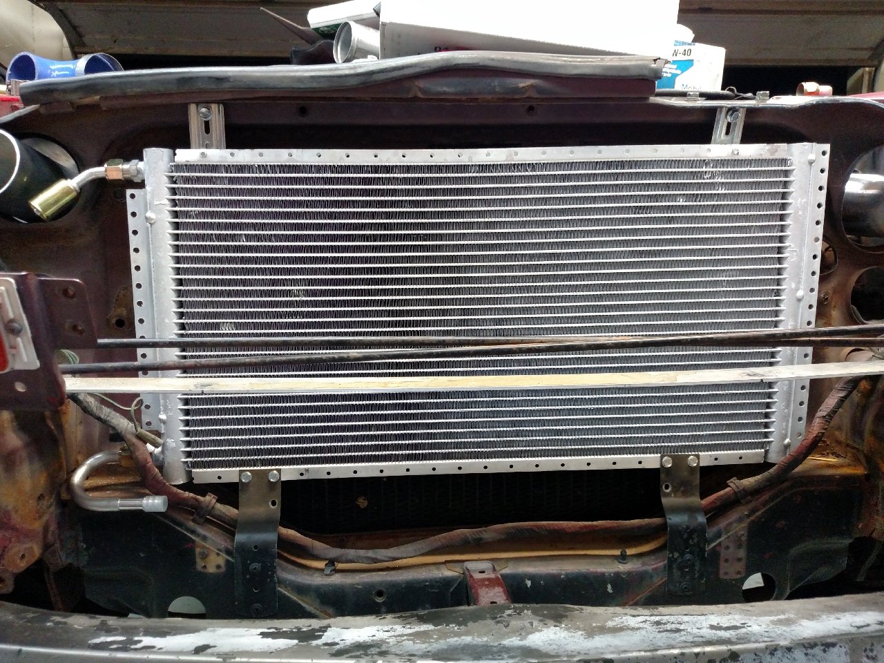

On the other zcar (1977 280z L28 turbo) i'm building I use an universal Parallel flow condenser, using a rotory Sanden compressor. Here are a couple pics of it's install to maybe help with ideas for you. I make all of my own hoses so I can choose hose length and fittings.
