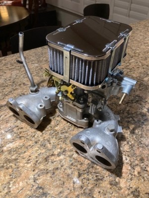

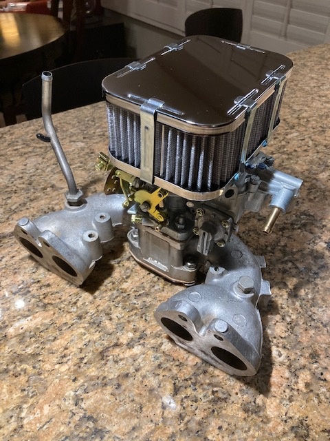

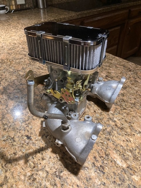

The 32-36 Weber carb arrived today with all the associated adaptions for a Datsun motor. Spent time this evening assembling everything. Still a ways away from bolting the manifold back on, but getting closer.

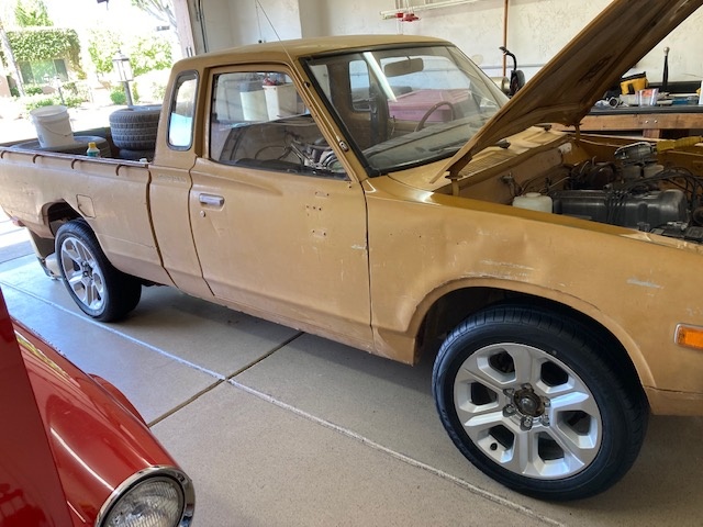

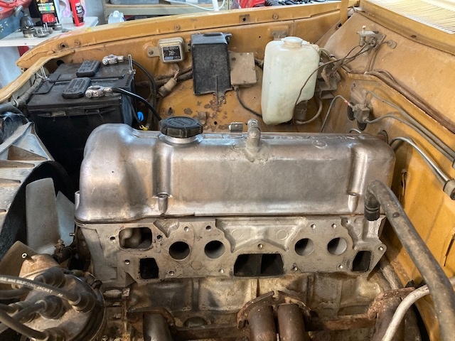

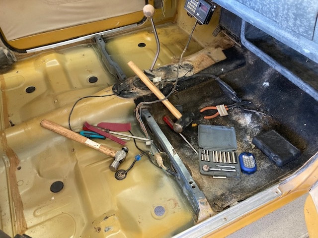

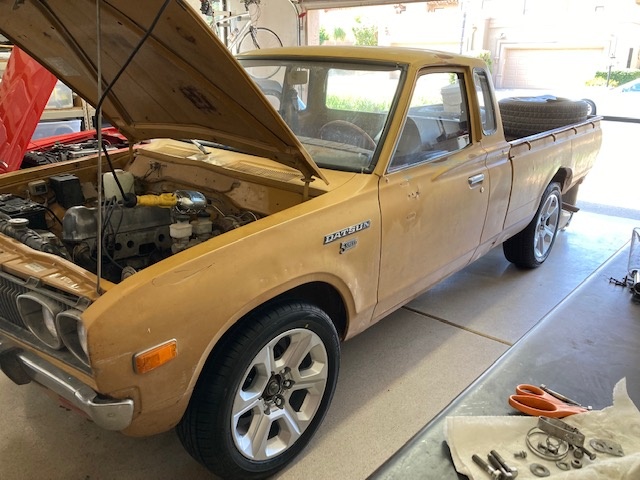

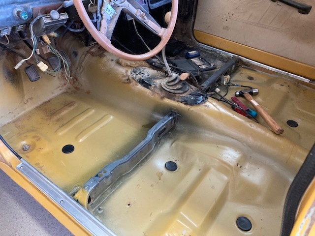

Mounted new Toyota TRD wheels and tires this morning. Have round Datsun center stickers coming, which will be affixed to the center caps. Continued ripping out the carpet and cleaning the floors, which are amazingly clean and rust free. Ron Q came over this morning, and with his help we were able to drill out the broken thermostat bolt and tap the head for new threads. This averted a much bigger job (thank you Ron!!!).
Coming along nicely Randy. Doing a nice job.
Great progress buddy. I have a fantastic PDR guy who could straighten that sheet metal... definitely would be worth the effort.
Not quite sure I'm feeling the wheels... The car Paul is referring to is Alice. She was acting up and he nailed the diagnosis.

Thanks Greg, do you mean PDR Tony? There are a load of dents on the 620. Not sure I could afford the cost of the whole truck
. Wheels are definitely a personal thing. Reserving judgement till the center caps are done. Definitely trying to keep this a budget build and the "like-new" TRD wheels were a steal for $150. Plan to drop the truck 2-3" which will change the look of the wheels. Definitely liking your suggestion to spray body color Raptor Liner rather than traditional black. Any L-18 bits you may have would be much appreciated, Thanks Bud!
