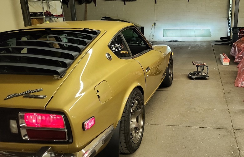

I finished off the rear suspension refresh/mods yesterday. This is the cleanest it's looked under there since I've owned it.
Installed the MSA T/C rod kit with the nylon & aluminum on one side. Those rubber boots are a real pain!
With the softer KYB struts I was getting some tire rub on the right side so I had to do some clearancing with my grinder and flap disk. Good thing it's fiberglas. I ran masking tape along the wheel well opening to get a clear indication of where the rub was. It took a couple times to get it just right.
