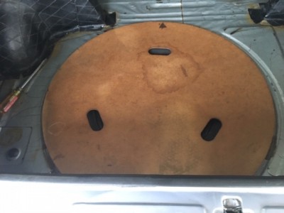

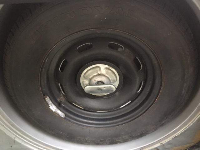

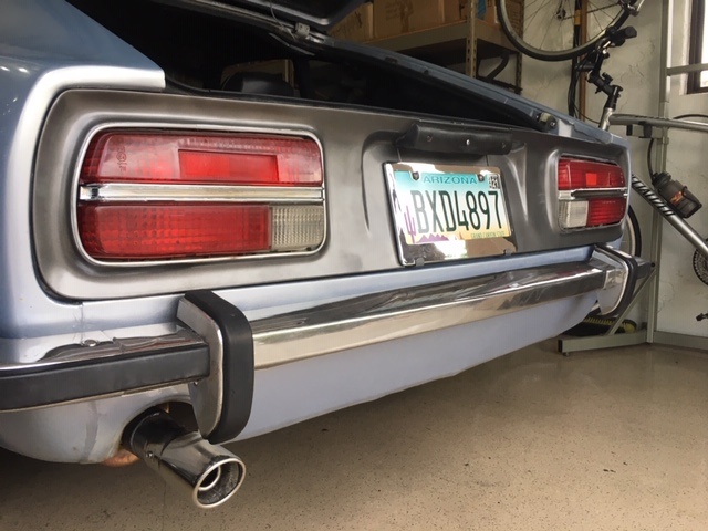

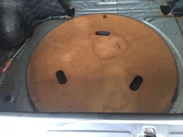

Finished up the rear end of the Z today. Took the taillights out and apart so I could replace the chrome trim and the rubber gaskets to help seal out any fumes. In the process I also cleaned up the hatch latch mechanism and cleaned all the bulb sockets of corrosion. Also had to replace two bulbs that were DOA. The spare tire well is spotless, not a bit of rust and the wooden cover is also intact. Also bought and installed a chrome exhaust outlet. All little things, but happy with progress so far.

Ryan, the car was in ID for a while so there is surface rust underneath, and I have a couple of areas that need to have a patch tacked in where there's a little rust through near the front stabilizer bar mount. That seems to be it.
