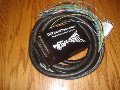

Been working a little on floor mounts for BMW E30 sports seats. Hoping to finish that project up in the next week or two. In the mean time, I have actually finished something.
I completed assembly of my Megasquirt ECU. I wanted to do the kit, since I used to enjoy soldering and electronics in general. I must say that my eyes were a lot better when I was younger. Anyways with the help of a magnifying loupe, I finished soldering and have assembled all the components. I still need to go through it with the simulator card to test all the functions, but it is good to be done with the assembly. The harness will have to wait until I rebuild the engine, which I may start on this winter ( I have most of the parts accumulated now, just need to send the block out for boring).

With that list in mind, I chose the MS3X kit for my project. It has the clock speed and power to handle the 360 slot trigger wheel, all the I/O for my wants, and has built in CANbus. The 3X also adds a couple of extras such as an SD card to save data for offline tuning and closed loop control for boost and air/fuel mixture.
- Megasquirt MS3X

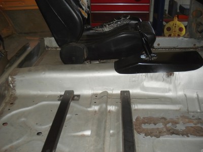

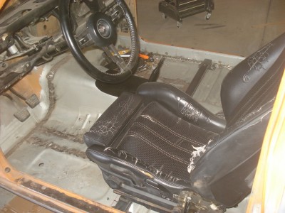

Seat Rails
I finally finished the seat rails to hold my E30 Beemer seats. I will restore the seats later.
The BMW E30 seats have a mechanism to change the tilt of the seats, they are a bit taller than the original 510 seats, and to improve leg room, they need to be mounted a bit further towards the rear. So, I wanted to level the rails from their original position which slopes down at the rear, move them towards the rear a couple inches, and get them as low to the floor as possible.

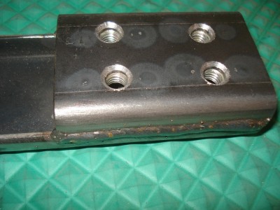

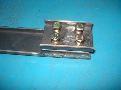

I tried a couple methods to get what I wanted to happen, and finally settled on two rails mounted cross ways in the car. The floor on the 510 is anything but flat, so I made anchor pads for the rails that bolt down to doublers in the flat areas along the door on one side and along the transmission tunnel on the other. I made the rails from 1/2" x 2" steel channel, welded nuts inside where needed, then welded the channels together to form a tube 1" x 2". Each end of the tube has a leveling pad to make up for the various levels the floor has in it.
- Drivers side seat in place.
- Passenger side showing rails in place
- Keeper nuts welded inside the tube
- Doubler for mounting
Posted: Fri Jul 24, 2020 4:19 pm
by Vetteguy22
Seat tracks look nice.
