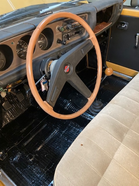

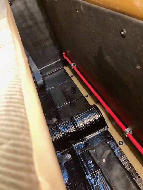

Finished DynaMatting the floor this afternoon. Still need to do the doors and rear of cab, but it definitely quiets things down. Also installed a new shift lever pin and bushings to tighten things up.

Looks good, Randy, bet it will be much quieter when you are done!
Did you use Fatmat or Dynamat? Where did you buy it?
Looks great, thanks.
Actually, it's a generic version rather than either of those brands. I'm sure it's not as good, but my budget build budget has been exceeded and I'm not wanting to dump any more $ in it than necessary. I did order a new speedo pinion today, however, in an effort to make the speedometer report more accurately. Changing from a red 20 tooth, to a white 19 tooth. Changing out the O rings and inside seal at the same time to see if that solves some of my oil leaking issue.
