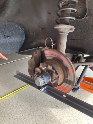

Replaced the steering rack boots and greased the fittings on the front end of the 240Z yesterday. The old boots were torn on both sides. Did my best to count threads and mark the tie rods with paint, but alas I still will need a front end alignment. Tried the easier way of installing the new boots by not disconnecting the tie rods at the ball joints. Instead I loosened the tie rod jam nuts and turned the inner tie rods to disconnect the outer tie rods from the steering rack. So much easier, and no risk of ruining the rubber grease boots on the ball joints. It was then easy to slip the new boots over the large flange on the steering rack and push the inner tie rod end through.
Just align it with a tape measure. I've done this many times on both my race Z and my street Z.

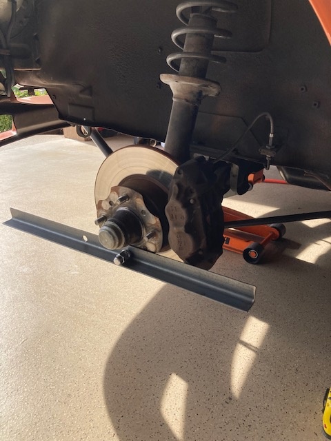

Saw a neat tool you can easily make for doing this on Instagram. Uses 2 pieces of angle iron (maybe 24" long) with holes that can be bolted to the wheel studs. Then you can easily/accurately measure from one side of car to the other. Think I'll make a set which is way cheaper than an alignment these days.
Randy, I have one of these if you want to borrow it.

Thank you for the offer Dale. I went ahead and made a pair of alignment tools and currently have them affixed to both front wheel studs so I can accurately measure toe angle. Since my steering wheel was perfectly straight prior to disconnecting the inner tie rod ends, I'm assuming setting the steering wheel straight is where I should start before adjusting the toe, correct??? I don't know the actual spec for toe in on a 240Z but I do know I need just a slight amount. Does it make sense to have the measurement about 1/8" different front to back, more or less??? Thanks guys.
