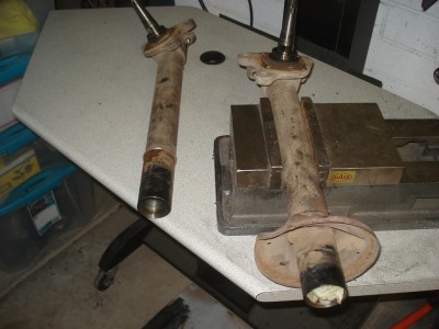

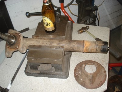

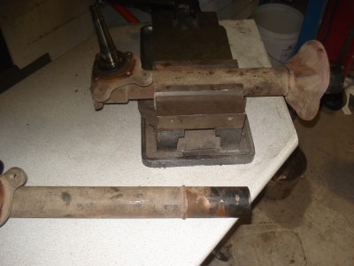

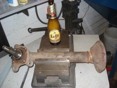

Decided to work on my front struts......
Blew off all the dust, removed the springs and the old shock insert. Cut off the upper spring perch by scoring it all the way around with a hack saw, then striking it with ball peen to tear the perch off where it was scored. Ready to cut and shorten the strut tubes for the new inserts now.

- Deeply score the perch slightly above the weld
- The original weld remains after the perch is removed
- After scoring the metal, tap the perch to tear it away
- Spring perches have been removed
