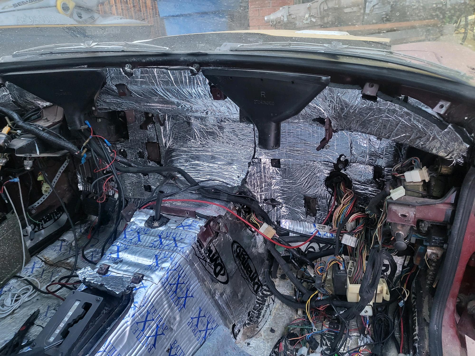

The butyl sound deadner installed, 2nd layer of self adhesive closed cell foam laid on top. I'm hoping for a significant improvent in the reduction of heat and noise from the engine bay.
1977 280z RB25det Neo
Dang! Hey, where does that blue wire with the white stripe go?Racerx3110 wrote: ↑Tue Dec 24, 2024 6:02 pm The butyl sound deadner installed, 2nd layer of self adhesive closed cell foam laid on top. I'm hoping for a significant improvent in the reduction of heat and noise from the engine bay.
