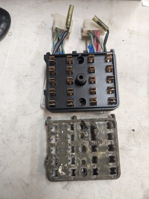

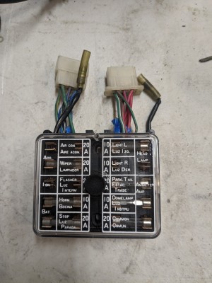

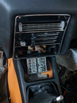

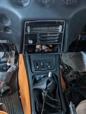

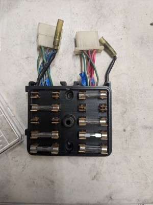

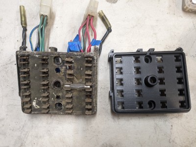

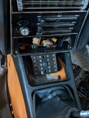

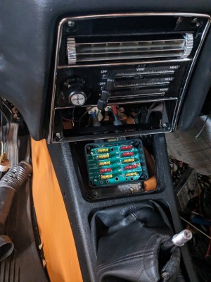

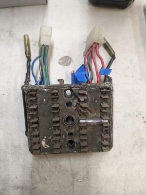

So, I built my engine harness and installed. I'm still working on the dash area, I purchased a fuse box from engineered 3d and transferred the fuse holders. I think it came out pretty good. I also purchased a fuse box with upgrade blade fuses from MSA, not sure which one I'm going to use. A new heater control panel from MSA was also installed.
I need to finish up the motor and get it ready to install, then work on the headliner and pillars before installing the windshield.

Sounds like you are making good progress Patrick. Rewire and new fuse panel is a huge leap forward. Looks good.
