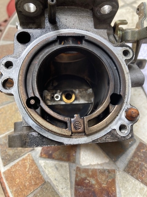

Well, I've got the first carb disassembled, and other than years of grime everything looks relatively intact. The first photo shows how far I typically tear carbs down when doing my rebuild (I count 66 parts). You can see in the other two photos just how gummed up the throat of the carb and the piston got after ??? years. From here everything will go into my carburetor Jacuzzi (hydro-sonic cleaner). It actually does a pretty good job of knocking most of the scud off. Hats off to Doc who gifted me the Jacuzzi (thanks Doc). It has a heater and a timer on it, making it both effective and easy to use.

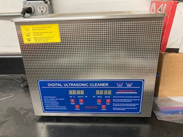

Here's the "carb Jacuzzi" I mentioned.

Very cool on the needles and other SU parts! What's an ultrasonic cleaner that size run?

Looks like Walmart has the same ultrasonic cleaner I have for $70. I'm using a Simple Green product in it diluted 4:1, but not the green stuff because we learned it will etch aluminum. The stuff to use actually says on the jug that it will not etch aluminum and it is purple colored. You can pick it up at Home Depot. Re: your race car, it would be a shame to leave it in MI or sell it. Hope you're able to find another alternative, Jeff
