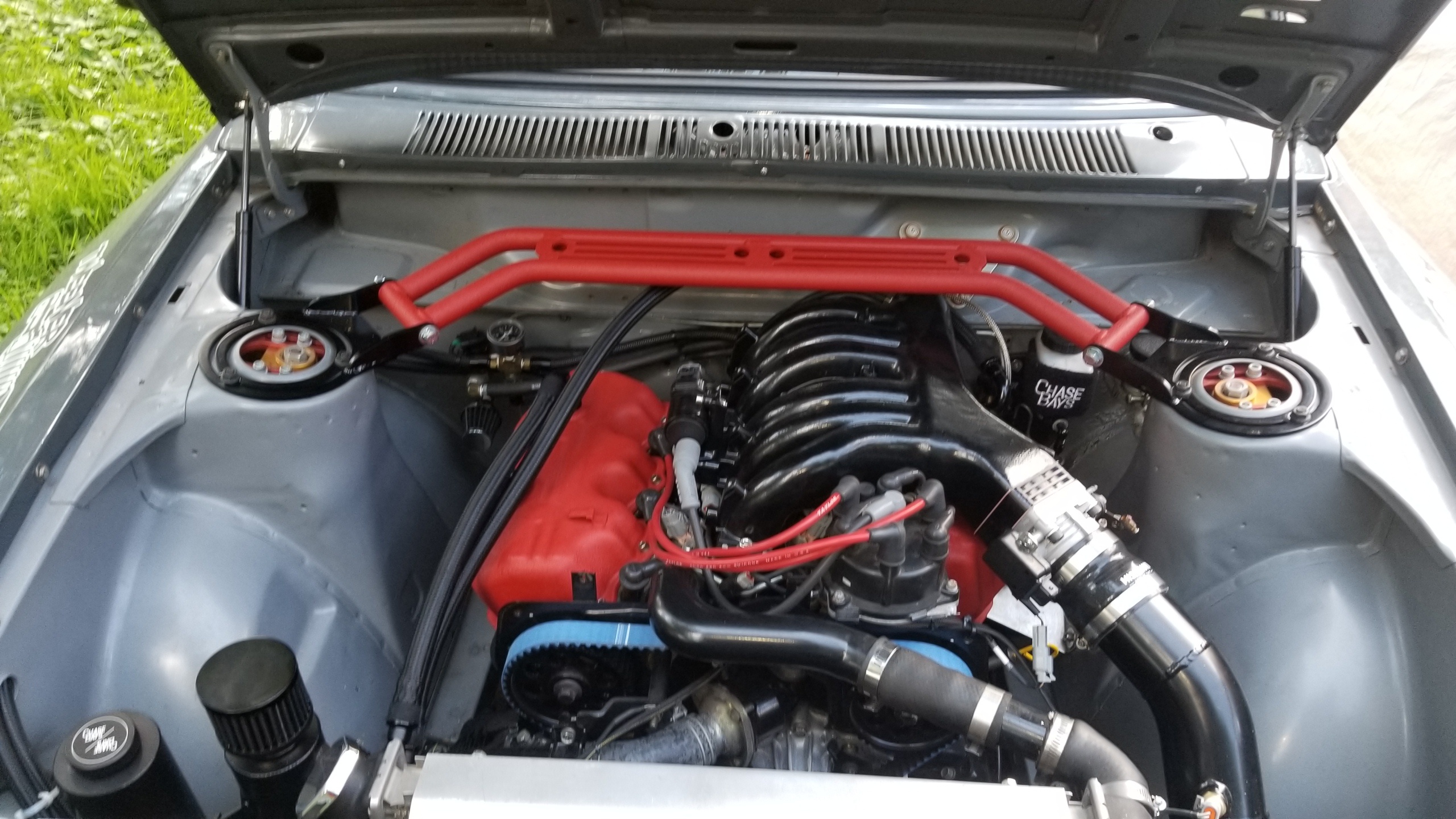

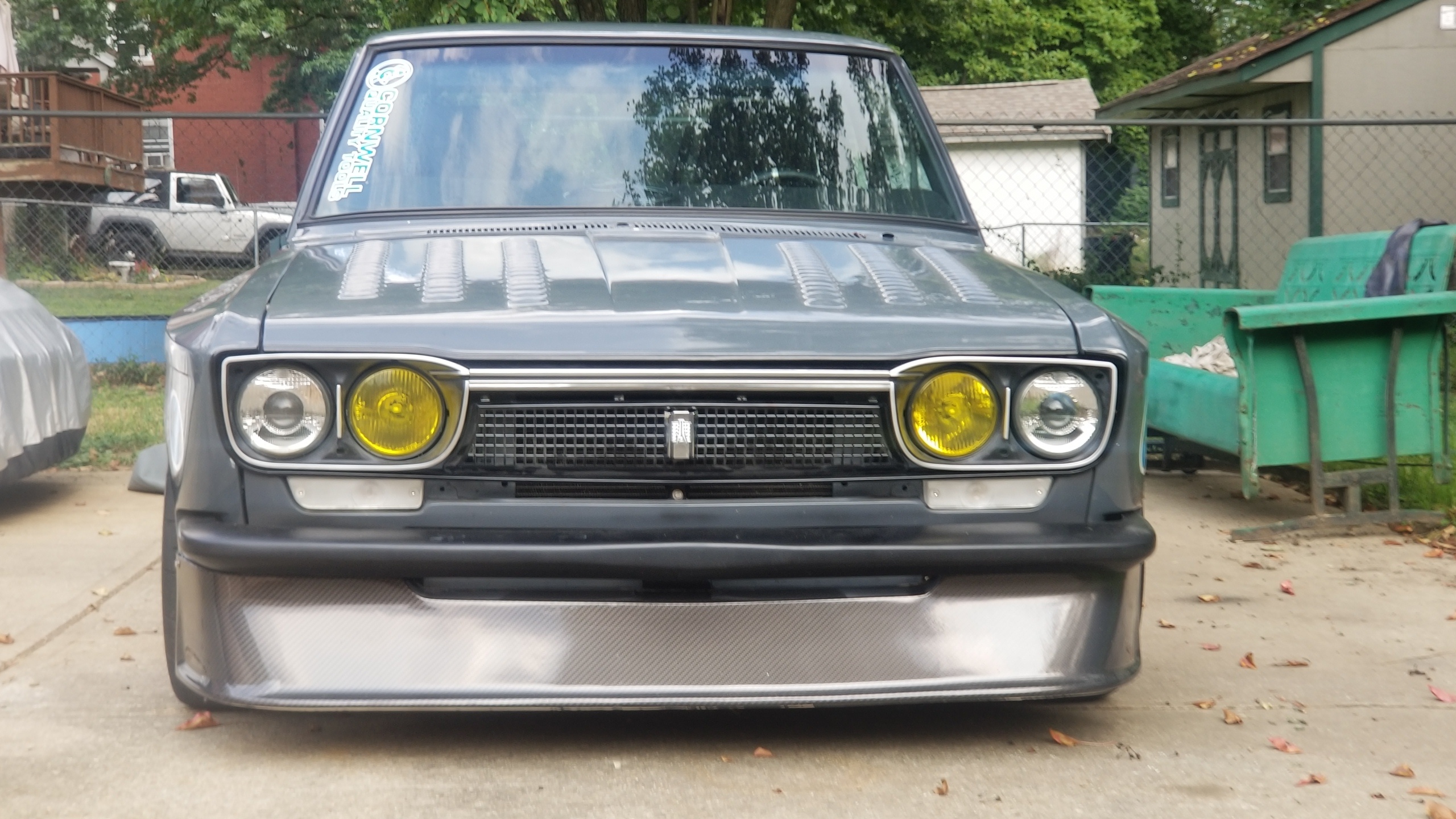

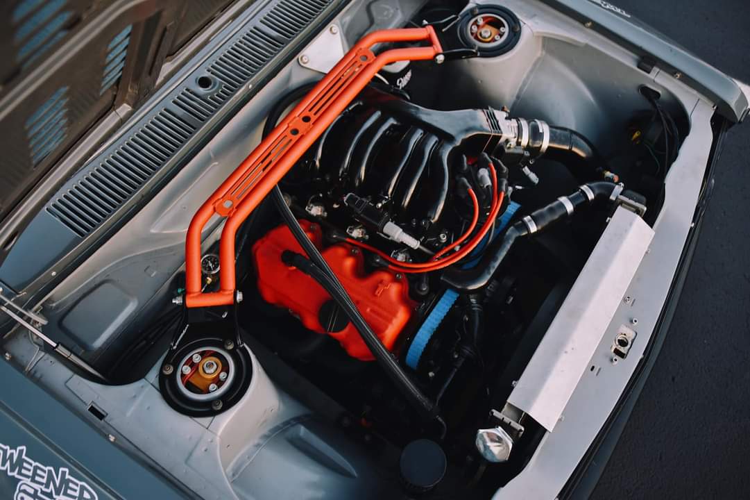

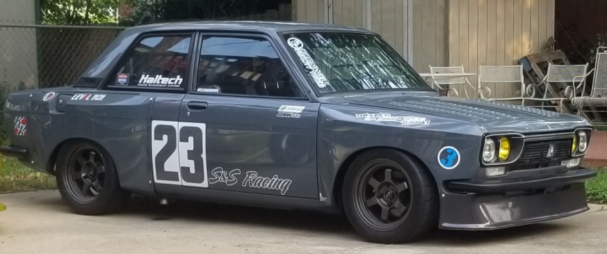

As some of u may have known Ryan..here is the current state of the car..
